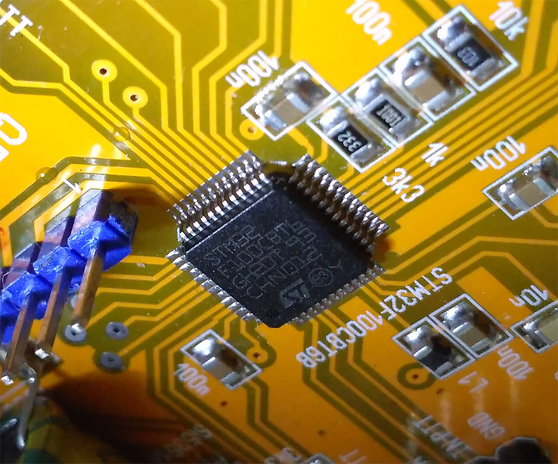

Did you upload firmware for F100? Because there is a firmware for F103.
The latest firmware for 2018 is all working, it has been tested many times.
I recommend using it.
synthesizer_stm32f100cbt6b_microb_v4_27122018.bin
Make sure you have a controller with 128kB flash on board.
I want to warn. Not all that is written is true. Here I have such a copy. It is written F100 and in fact it is F103.
Thanks to the Chinese brothers!
