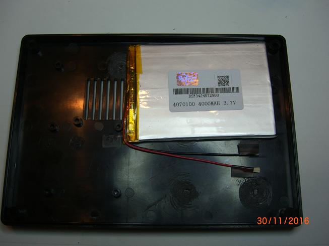

First try. Thanks to mirekfd !
No success.

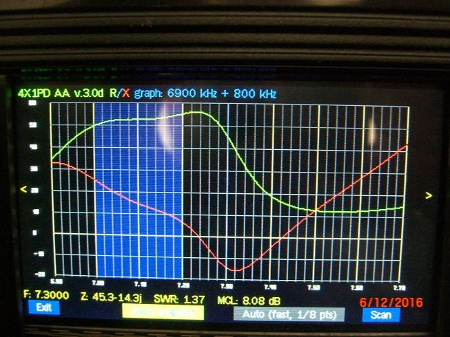

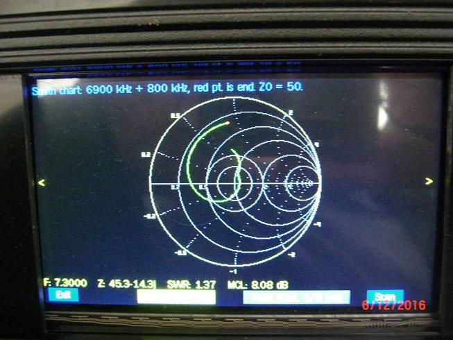

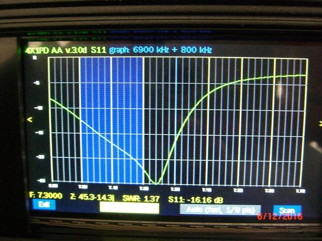

Second try. Inverted-V 2el. results:
Dov 73!

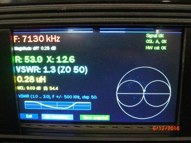

Inside AA-V3:

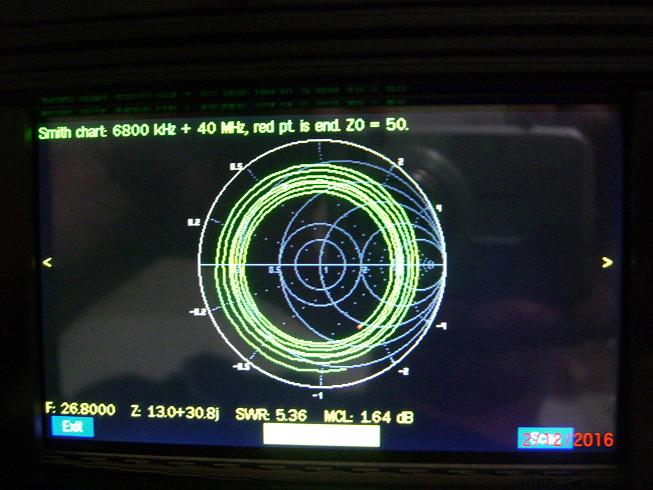

Open coax long length:
