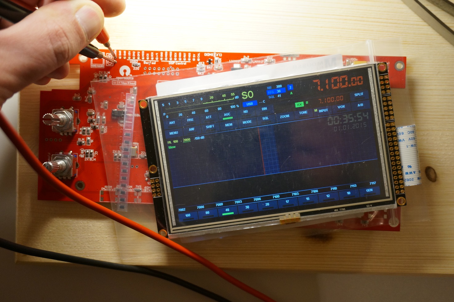

I have replaced STM with old one, which i thought was dead, but...
Tadaaaa! It is running! At least it show interface and respond on buttons and screen controls Smile
One more question... how to check AD9952 is working if i have not oscilloscope?
Trying to tune with handheld wide range scanner, but found nothing.
upd: 100mhz TXCO is working, i saw it signal on scanner.
