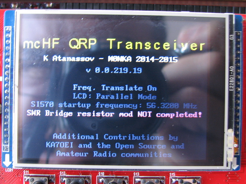

2. Wczytałem nowy firmware 0.0.219.19 i na wejściu niespodzianka:
Należy wnieść poprawki w mierniku SWR/PWR jak niżej:
• Remove R59 and R60 and replace with zero-ohm resistors or jumpers.
• Change R58 and R62 to 2.2k resistors.
• Change C82 and C83 to 2.2uF resistors.
• Replace R55 and R56 with 47uH inductors. If you do not have these, 4.7 uH inductors will
work adequately.
• Additionally, it is recommended that one capacitor each of 1nF to 100nF be connected between
pins 9 and 10 of the 30 pin edge connector on the RF board and ground (pin 6).
Innych problemów nie zauważyłem...
